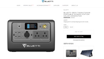

My Agm is getting old was looking into a renology 100ah Leisure battery, then I notice the price on the BLUETTI EB70 so which one would give more bang per buck?
The Bluetti would only get used in the van I guess it would be easy to take with if I sell up that said however in the current climate I will keep the van for at least another year .
A plug in and play folding soar panel would work on both for park up top up Bluetti also has this on offer at the moment
So what would you buy ?
depends on your needs.
EB70 has half the capacity of the Renogy, but is a all-in-one solution.
BLUETTI EB70 = 716Wh - worth of power
Renogy 100ah = 1200Wh - worth of power
The renogy you would need to add the charger and inverter to get the similar like for like comparison.

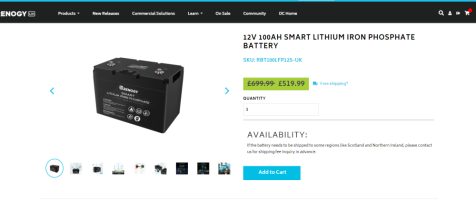

@Dellmassive Do you happen to know why the Bluetooth version of the Renogy 100Ah is cheaper than the 'Smart' version? Is the Smart version better somehow? Also, does the bluetooth version fit under the driver's seat?
@eirej
im not sure, its different cell tech and a different BMS, and case design.
maybe they doing the new version cheaper as a promotion?

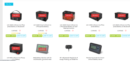

This is the current Renogy offering
100A smart = £499 + £29.99 BT2
100A smart heated = £599.99 + £29.99 BT2
100A w/BT = £459.99
