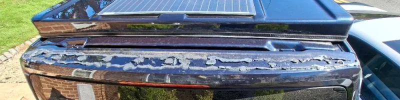

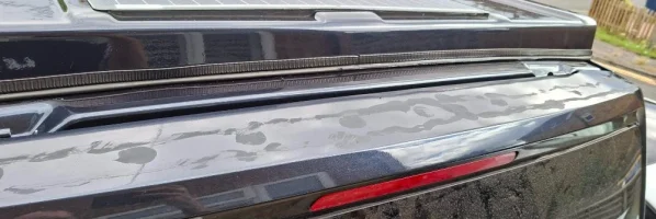

Just thought and I think Lee @Dellmassive used a toffee wheel to get the adhesive from a flexi solar panel off of his painted camper roof.
Toffee / caramel wheels are really good but you will need to get as much off as you can first without going near the paint. Try a decorators knife or Stanley knife blade.
To get most of it off, try slicing with a naked Stanley knife blade, holding it flat and slightly twisting from side to side you can get very close to the paint surface. Flat is the answer, as its about 1mm thick with a double bevel knife edge so will leave about 0.5mm on the surface and you should be able to pick the rest off.
Thanks all for your advice. It's all off now. Just to close the thread - Took a couple of hours by (1) cutting it down as thin as possible with a stanley knife, (2) soaking gum in isopropyl and scraping off with plastic razor blades. This then left, under the bonding, a black etching primer on the paintwork which was then (3) taken off with t-cut on a green scouring pad. Luckily no damage to paint. @Touchwood - I would not have liked to tackle the full width of a tailgate like that! That's a lot of work!
