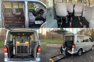

Hello All, thanks for the replies, attached is the type of modified van we were looking at. I was intending to remove the ramp and return it to original state to then fit a tow bar, but I sent the photo to a tow bar specialist this morning and was informed that there would be no way of doing so. Oh well! Back to the hunt for a base van :)

That looks ideal for putting a motorbike in the back!
That looks a very similar set up to mine - do you have a link to the sale ad just for interest? I've added a few pics of starting to chop out the ramp - I've bought a complete floor from a breakers and will weld back in sections
