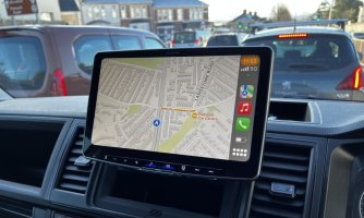

If your budget allows then the Alpine Halo 11, great bit of kit! Also has a dedicated camera button.IMG_4240.jpeg
