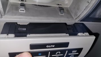

May count is 1 broken and 2 bent out of 4 on the 1st try. Took one from lamp pod.
They get stuck and bent behind the control panels plastic edge.20230420_015302.jpg
If I would do 2nd time I would pull out the panel straight down from both edges without wiggling side to side so the clamps don't get caught deeper behind the plastic edges. The sides of main panel are pretty elastic so you can put some plastic stuff in there and try to get the gap as big as possible.
I think I will also cut some plastic off the straight plastic edge as 3 out of 4 clamps are bent now in two places
I will also lubricate with silicone when I install the control panel back.

Offtopic: is there a way to remove the ceiling climate panel without breaking the clamps?
If you get 4 thin flat metal blades, like a classic butter knife, you can slide them into the gaps where the clips are and that will release all 4 clips.
Luckily I had a second hand one to look at and figure the clips out out of the van...
