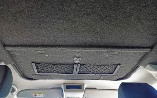

I've got a shelf in my van all the time (it's been there for over 4 years now )- it's just a piece of spruce board with carpet that fills the space between the bed board and the front of the pop top. Couldn't live without it and it's amazing how much stuff can go up there. The press studs are for a black out curtain for one night stops and the nets are self-explanatory.
PS. It also makes it a lot quieter in the van when driving at speed!
