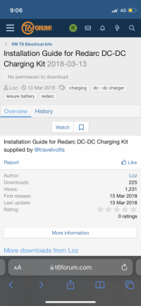

Thanks, I found this but don’t have permission to download it. How would I get access?
