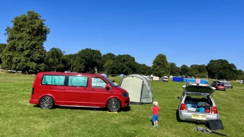

Took it to VW Festival for the weekend.
Then tinted the fog lights yellow and had another weekend camping near the Lakes.
