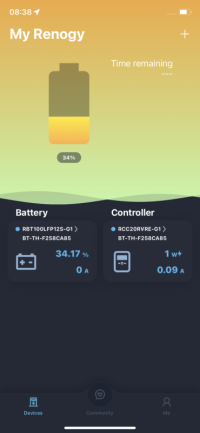

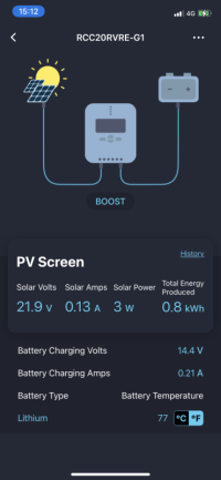

I’ve 2x 100w renogy solar panels connected to my renogy 100ah battery. It’s quite sunny out but today I’ve not seen over 3w of charge? Any ideas why?
Battery isn’t too hot, panels are fairly cool. I’ve tried unplugging and reconnecting.
How they conected?
And post a screenshot of the mppt screen.
And settings page

Panel voltage is healthy, usually (but not always) this drops off if the panel itself is faulty.
Are you sure the battery’s internal SoC estimate is correct? If it was actually full then that would explain it. You can test this by turning some loads on, if the power produced by the panel rises then this could be what’s going on.

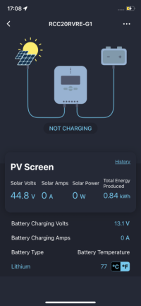

I did a quick test with them in series, but it didn’t charge at all.
I think battery voltage is correct. I charged it fully before I left. I’ve boiled a 800w kettle a few times which uses 4-5. Ah, and I’ve had my fridge on a few hours. The fridge uses 6-7amp because it’s a 3way fridge, not a compressor one. The battery level is consistent with the amount I’ve used it.
Screen shot was the solar panels connected in series
