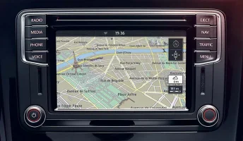

As in the title - I know a fair few of you T6 owners have got the Discover Media fitted and wondered what you thought of it as a replacement for the basic Colour Composition that I have at the moment. I like the OEM look and there are quite a few unlocked ones out there at a better price (and availability) than the after market stuff from Kenwood or Alpine, particularly if you want native sat nav. I would intend using it with the current OEM speaker set up but probably change them in due course. This is the one that I'm thinking of - any comments / advice much appreciated.

Would anyone be able to advise on part numbers to upgrade composition to discovery.
It is just the main unit and screen that is required? I’m not sure I’d parts are different across the platform. Screen looks the same not sure about main unit. Various sellers on eBay now selling unlocked and fully activated units.
The T6.1 uses quite a rare Mib3 unit not found in the Golf. Think it's from a passat or something. It doesn't have the SD slots or cd player.

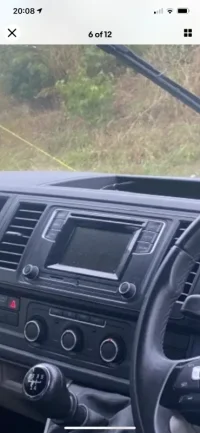

Below is a pic of mine
Sorry. Not sure on the display. You'd have thought they were the same but will have to hope someone with more info replies.
