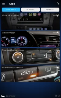

Just how does the credit system work on OBD 11. How do you get credits that are worthwhile as I see some functions/apps cost 100.
So How much do they cost if you have to buy them? I think you get 1 per day free, but that ain't much.

The credits are needed to use so called "Apps" within OBDeleven. The Apps which are just "one click functions" to code or adapt things. For the nerds using Apps there is no additional value. Everything can be done using coding and/or adaptations of the control modules themselves.
Then re T6 - at the moment there are not many Apps for T6 (just 4+2). Actually I'm not sure if any of them works on T6 - except the oil service and inspection service resets - of course. But as they can be reset using MFSW/stalk buttons not much added value there.
The above applies also to T6.1 - at the moment.
However, for more modern platforms than T6 there are more Apps already available, e.g. even old Golf (MY2014) more than 70 Apps. But again - doable through codings and adaptations.

Hello! Still wrapping my head around the credits system. Do you spend credits to ”install“ the apps, or every time you use the apps?
Every time when you use the app - e.g. for "Oil service reset" you need 10 credits for each reset.
However all the functionality of the apps can be done "manually" - just involves more steps & some know-how ;) as mentioned above https://t6forum.com/threads/obd-eleven-and-credits.19676/post-269654
