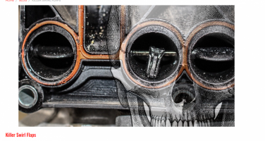

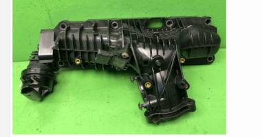

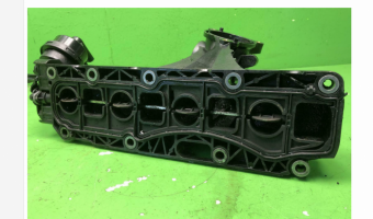

But sounds similar to an old bmw 530d i had.... it was the inlet runner flaps on that engine...
They were vibrating in the airflow at certain rpms.
The fix on that engine was to remove the runner flap assembly from the inlet manifold (swirl flaps) and get a set of blanking plugs....if not addressed the runner flaps could break off and be ingested into the engine.

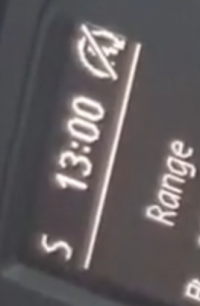

If you just let the engine idle, do you also get disabled Stop/Start when it's happening?
At the end of the video clip:
cant talk for
Cant talk for the person in the video here, i only have the same wierd sound as him, but my start stop works when the wierd sound is accruing, and sometimes the sound disappear after the restart.

I'm sure its not swirl flap related as the sound is too regular. As mentioned in the other thread by @Loz it could be the air control (Moo) valve. It does only appear to happen during regens and only when warm. I've just got used to it and it doesn't seem to be getting any worse in the 15000 miles since I noticed it.
