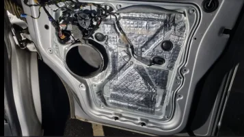

I’ve just found the passenger door speaker has no sound and the tweeter in A pillar is very very quiet, all the speakers are the Alpine set, fitted professionally a couple of years ago, is it a case of taking off the door card and checking cables etc, van has the standard head unit on 2021

After you checked the balance settings are ok.. check the terminals on the speaker itself , as good chance moisture has corroded them

Yes checked the balance settings on head unit, all ok, so I’ll check the door speaker and terminals etc tomorrow if it’s a dry day
I’ll report back what I find
Thanks
I recently had this , turned out to be corrosion on the door speaker connections as Absolut5 says .
