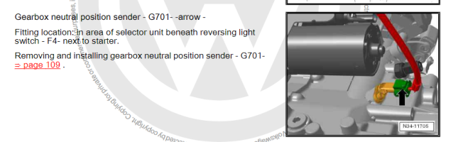

Where abouts is this sensor on the gearbox?

Anyone know where the neutral position sensor/sender is located?, on the gearbox?, the document linked above is no longer available.
can it be a diy fit, does it require coding or is it a plug and play swap?

Yeah, tried a few different options, not working for me. Is it the same manual 6 speed OA5 manual that is in the members downloads section?, if so I can’t find any mention of the neutral position sensor.
If you are trying to access the cardigan.com site type it into your browser address bar as the site security won't allow access via links!
Here it is from that website using the URL above but not as a link.
