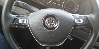

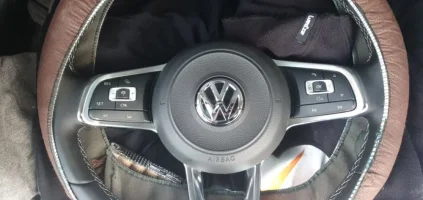

I did an upgrade to the steering wheel ... unfortunately the buttons do not work and the bulb remains lit from ACC, ESP ... etc.
The lights on the steering wheel controls turn on but do not work.
Does anyone know what the cause is ... why doesn't it work?
Tricky to follow what you have done here...are you saying you took the standard T6 MFSW off (photo 1) and replaced it with the Polo wheel (photo 2)?
Have you literally just unbolted the old one and bolted on the new one?

Thats a polo wheel...the round black springy thing is the giveaway. in summary, you airbag wont fit (unless you was planning on buying that also?) Your looking for a wheel with 2 hooks in the cast aluminium part, not the 3 black plastic circles to retain the use of your current airbag.
