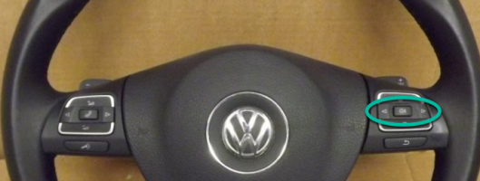

Do you have a Multi-function steering wheel? if you do then you press the right-hand side menu button, else you use the menu button on the stalk.

pushing the arrow buttons on the right side of the wheel should move the selection over to another screen ?

Tried that no joy,shows adblue range, phone,navigation,radio station,still same problem,settings stay on,Think disconnecting battery may help,or make it worse..
Thats what its supposed to show, you choose which one to leave it on and then can go up and down within those menus to choose different aspects ?

Right on, cannot navigate away from settings page when engine is running ..
Are your buttons working, can you move up and down in the settings page. Check in MFD Data menu and make sure the screens you want to see are ticked.
Sounds like the silver left and right button may be faulty then. Do you have access to VCDS or maybe someone local to you with VCDS who could test the buttons?
