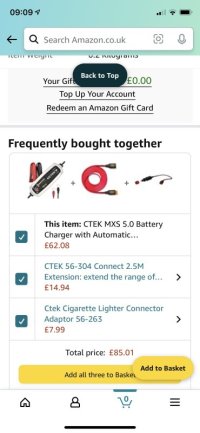

See attached for my battery (factory Varta 70Ah 420A DIN 700A), and also attached pic of what I plan to buy (CTEK MXS 5.0 with extension cable and also cigarette lighter connector). I plan to run CTEK extension cable out through garage and into van via tailgate then attach to 12V socket in van.

1. Does CTEK Support AGM Stop/Start Battery?
2. Is lower dash 12V socket in van permanent live?
3. CTEK cigarette lighter cable is limited to 7A, with CTEK pushing out 5A so this should well be within 10A limit of 12V van socket.
