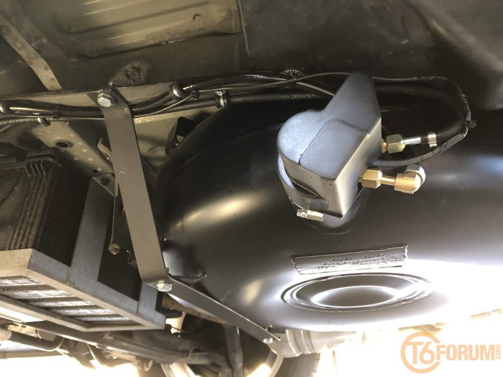

Tank is where the spare wheel is so no reduced space.
runs on petrol as well, if lpg runs out it’s seemlessly switches over
