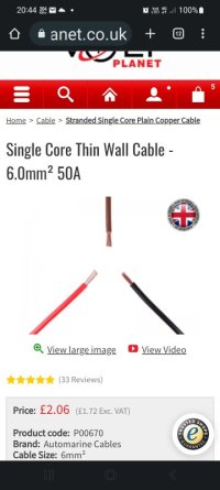

6.0mm2 shows here at 53A.
But you have a long ish run..
So
25A shoul be ok.
