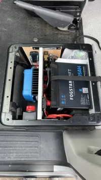

A lifepo4 is definitely recommended as the way forward to give you the capacity, rapid charging and flexibility of positioning. Have a look at Fogstar for good value batteries from a UK supplier. If you are using the van in winter you may want to look at the Drift as it has a heater, if not the Eco would suffice. These batteries can go on their sides and fit under the seat. Here’s mine:
