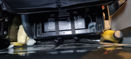

i used one of those battery trays too . . . with two webbing straps
see some pics here:
where VW put their leisure battery setup
- VW OEM use a battery tray that bolted down, and a battery securing tab and bolt . . . . the same as the starter battery.

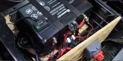

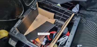

Renogy Lithium 100Ah + Battery tray above (well now swapped it out for a bit of 6mm ply wood) + webbing straps + Neoprene sticky foam . . . .
1643552020756.png1643552032450.png1643552045837.png1643552079700.png1643552096221.png
I've had to come in, its too cold to do this all day. I've got the base plate for the dc charger built, but i think i want to look into a couple of bus bars for those connections. do we have a preferred choice of bus bar for use under a seat? i can see loads on ebay, but not many that come with a cover. i feel like a cover is a must.

I used a 3 pole busbar for collecting the common negative and positive wires under my seat, you can just see the negative one in the second picture of mine above.
