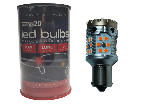

I've got a Kombi with LED headlights and tail lights, have already replaced the reverse lights with LED bulbs, and also replaced the rear indicators with LED bulbs. I added some resistors to the wiring and they work as normal. i added some LED side indicators and they work just fine too (no resistor was need for them) - no hyperflashing at the lights or the dashboard, no bulb errors showing.
However, when i tried doing the same for the front indicators. No matter what i try, i end up with the dashboard showing a bulb error and the interior indicator hyperflashing. I've tried one resistor, another resistor in case there was a fault, both resistors in series. Connections were soldered so there should be no connection issues. The only possible thing i can think of is that i connected to the wiring inside the weather cover that connects straight to the bulb holder, not the loom that plugs into the back of the light but i wouldnt have thought that this would have made any difference. Any ideas??

What resistors have you used?
I fitted leds in the front indicators without any problems. Im sure I fixed the resistor across the back of the bulb holder too. It must be a connection issue.
I did however take them out because I didn’t feel they were bright enough, certainly they were no where near as bright as the incandescent bulbs,
@Deaky I wouldn't have thought it would have been the connection as I'd soldered it in first time, then tried crimping in case my soldering was not up to par.
Regarding the bulbs however, the ones I got are far brighter that the standard bulbs. Happy to take some video and post it when I get it working
I fitted VW LED Tail lights to mine from a kit from Advanced in car Technologies and to get rid of the fast flash of your dash tell-tale. one side of their resistor had to be earthed to loom and NOT the body... if it was to the body it continued to flash double rate.
Figured out the issue with the front indicators, managed to get them working by removing the led side indicators that I'd fitted. So I now have led front and rear indicators but incandescent side bulbs again.
Tried a number of different w5w bulbs which are apparently canbus but all of them hyperflashed. Need to have a think about my next move
