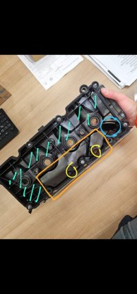

VW implementation how to eliminate oil from crankcase breather system getting back into air intake:
  • Specifically about Transporter EU5 engines on page 13 in VW Self-Study Programme 455: 2.0l TDI engines in the T5 2010, which is available at SSP_455 EDIT: also in the Forum downloads --> SSP 455 - 2.0 Litre TDI Engines in the Volkswagen T5 2010
  • More details about the principles in general on pages 18-21 in VW Self-Study Programme 403: 2.0l TDI Engine with Common Rail Fuel Injection System, which is available at SSP_403
Did you find what was causing these problems. I'm having the same issue. Replaced the oil cap but it didn't work.
RayT6,
It’s been fine since I cleaned the cap seal and filler neck and refitted
