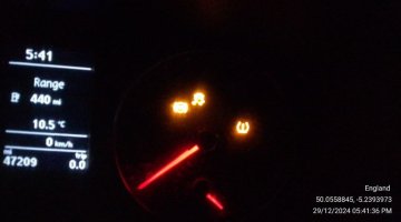

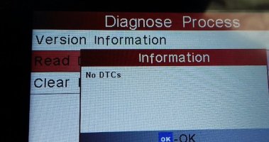

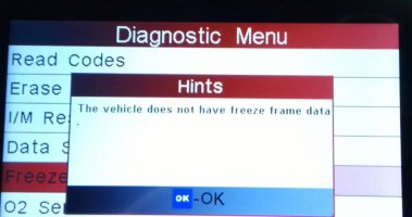

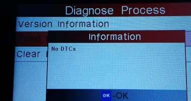

I have just purchased this code reader (which was recommended by Scotty ) for £99 to read the fault code for a suspected ABS sensor. I need to know which wheel is affected. There are three warning lights on the dashboard Traction control, ABS and Tyre pressure which never extinguish. I was trying to save the local garages' quote for diagnosis of £50. I want to change the sensor myself. However the code reader works but no codes were found. Has anyone had experience of this particular reader? I can still return it for a refund and have thought of trying the Carista OBD at £27.99. I have a VW Transporter 2018 Petrol Bus 2.0 TSI FWD Mk VI SGB,SGC,SGG,SGJ,SHB,SHC,SHJ 1984cc 110KW 150HP CJKB: Any (not rude ) comments would be welcome.

Interesting... also as there were no fault codes as a real low pressure incident always triggers a fault code (of course assuming the code reader can actually read VW ABS controller).

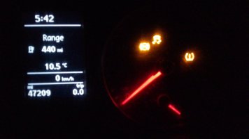

Could you please post a picture of the dash lights?
Any work done on the van before the warning lights?
I had a new tyre fitted to the front right about one week before the lights appeared. The oil service has been done but light not cancelled. I have driven 700 miles since they appeared, the tyre pressures are ok.

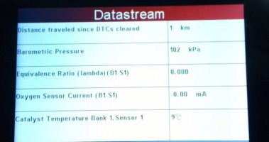

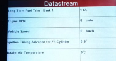

Can you read live data from sensors with the Launch?

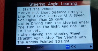

Please check what ABS controller reports for steering angle - are the values realistic - e.g. should be 0 steering wheel centered?
What about steering angle sensor itself (controller 04)?

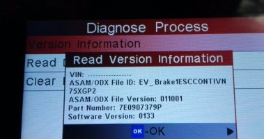

Can you read in what mode the ABS-controller is?

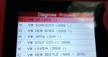

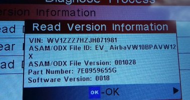

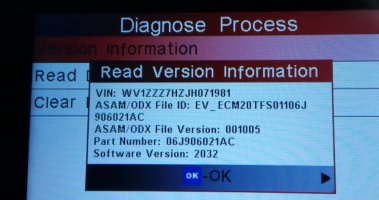

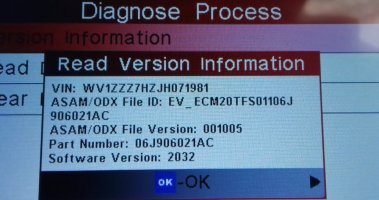

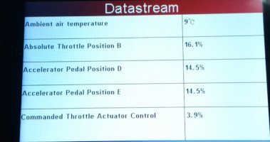

I have copied some of the screenshots from the LAUNCH. It didn't seem to have my exact model listed. I couldn't find any answers to your questions and I searched through everything.
Reactions: mmi
Possibly there simply is no such a capability. The datastream values on the screenshots are from engine controller. The ABS controller is a different one (as well as many others, e.g. steering angle controller, central electrics, battery monitor, gearbox, etc.).

I'm suspecting steering angle sensor (or associated wiring) being the culprit but certainly would like to verify instead of just blindly replacing parts.

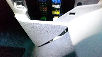

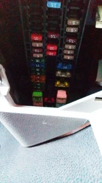

I have checked all of the fuses in the engine bay fusebox and all are working. I have checked most of the fuses in the cab fusebox and all are working. I used a multimeter. The problem is reaching the lower ones as there is limited room. I can count eight fuses ( some "blocky" ones ) that I cannot reach.CAB FUSEBOX .webpCAB FUSEBOX 2  .webp

I have just taken the van to Eastwood garage in Penryn where the fault was diagnosed as CODE C101D14 Rear right ABS sensor. He found the fault within one minute and declined to charge me. I am going to try to fix it myself!
Interesting that the Launch didn't read the fault code - even though showed some details about ABS controller.
