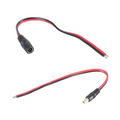

So, my extension cable has arrived, cut the unnecessary socket off the end and stripped back expecting to see one red, one black wire.
Instead I have one white wire surrounded by a sheath of other wire. I've gathered up this.
Do I take it, these are the equivalent off the red and black wires ????
@Dellmassive @Pauly
Yes, normally the centre core will be positive and the surrounding conductor will be negative (we refer to it as concentric cable in work)
After separating you can slide a bit of sleeving or heat shrink over the bare conductor and it will hold it together for you and make it a bit easier plus I prefer it as gives a bit of separation
Lovely, cheers.
I did try it much like you described and it all started working.
