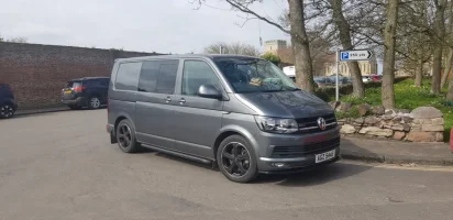

20190401_134454.jpgjust completedjust completed a 430 mile drive home in my new van and absolutely love it.
Lovely to drive
