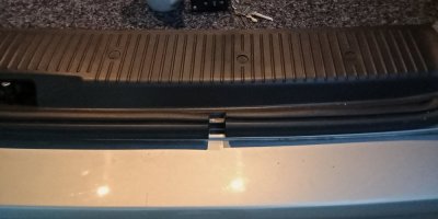

Hi all,
My tailgate seal has a gap of about an inch at the bottom. Maybe it's for drainage? It's an easy fix to buy a new seal but keen to know if anyone else has the same?
Its going to let a lot of heat out of the van in the winter and after doing all the insulation to a high standard it seems bit odd to have a big gap open to the elements.
What's your thoughts?
I think there’s been a revision between whole and split seals - I can’t remember which is current.
You just need to pull the seal away from the body and pull it round a bit, and then it’ll meet in the middle again.
Whoever refitted the seal didn’t stretch it quite enough.
You just need to remove it one side at a time and gently stretch it a bit more as you refit it.
Pete
an easy fix Just peel the left hand side off to the light fitting and tension it and you re fit it. run a thin trim tool run carpet side
