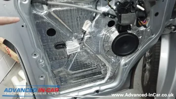

That's the kind of feedback I appreciate @Dav-Tec, thanks for replying. DXX gave me some solid suggestions about sound deadening that confirm stuff I've seen and read before. There's currently no deadening at all on the door cards, so I've bought some acoustic foam, which I plan to install by copying the attached screenshots I took from an Advanced In-Car Technologies YT video. I was also going to try to copy the wiring setup, but the audison crossovers in the picture look much smaller than my hertz ones, so I just need to either install them more securely in the same position or move them somewhere else.

I'd relocate the crossovers to the dash area although acoustic liner should help isolate the rattles. Taping the speaker wires together is fine.

Really appreciate the thorough explanation @Dav-Tec thank you. The outer door skin just has silent coat, no closed cell foam. The inner skin (as pictures show) is just silent coat as well.
So I can get some closed cell foam to put on before I use acoustic foam at the end. I have some left over dodo mat hex pro (just mat) and some duo (mat and closed cell foam) from doing my rear van floor and ceiling myself. So I can add some to the door cards as well.
