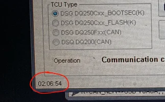

Just to make you aware of the update process, it took 2h07m to upload single ODX file of 35.15MB in size with VCP.
