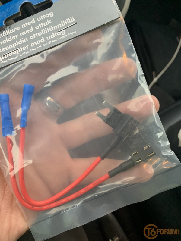

Tried to search the forum and looked at 100dreds of google images, trying to find a ignition remote for the wvt6. i cant find it anywhere. can anyone help? i found a image that showed one pin being ignition remote (nr 15 on iso connector) but in my car this particular connector is not there, nor the cable.

I suppose at the end of the day, the simplest way is just an ignition feed.
