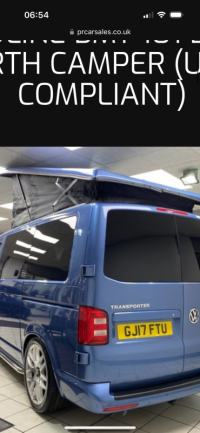

There is a video of it here, not sure if it is possible to tell the construction from that?
Mine makes no noise, squeaks, rattles or wind noise, even up to 100mph.
On those photos is the roof all the way up as the canvas looks saggy. It might just be that everything needs adjusting and it will be ok.
But as mentioned before some pop tops have a frame made of 4 seperate pieces just riveted in the corners. I can’t see how those can be strong enough to prevent the van structure from flexing and squeaking.
Some have a fully welded pre made steel frame that is fully riveted into the van. From my experience that won’t squeak.
Hi Bigsidavies,
I think it is all the way up - but can’t remember 100% when we looked at it - but will have a better look when we go back to re-test - guessing from your comment it should be tight?
