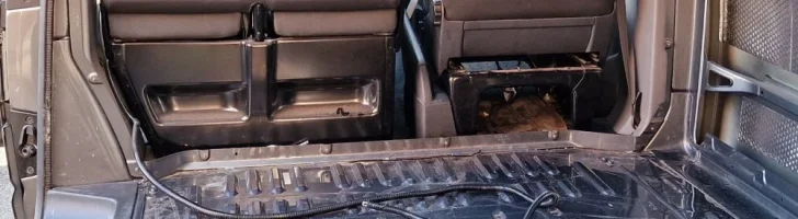

D DrPhill Member 27 Aug 2025 #1 Can this be done with simple tools? and is it easily reversible? I'm thinking thinking through pros and cons of buying a van to convert, but wondering what to do with the dog....... Thanks in advance for any help Phill
Badjamin Live long and camper! VIP Member T6 Legend 27 Aug 2025 #2 I think it's a socket and torx screw job. I did a video between 2 mins and 4 mins 30
doncarlyon Senior Member VIP Member T6 Legend 27 Aug 2025 #3 The bulkhead is easy to remove. Especially the top half. But there is a bracket type section along the floor that needs cutting out.
T6ChrisO AutoCAD engineer VIP Member T6 Legend 27 Aug 2025 #4 Yeah as above, easy but you will then need to cut/grind out the brackets on the floor from memory
D DrPhill Member 27 Aug 2025 #6 Badjamin said: I think it's a socket and torx screw job. I did a video between 2 mins and 4 mins 30 Click to expand... Thanks, that’s exactly what I needed
D DrPhill Member 27 Aug 2025 #7 doncarlyon said: The bulkhead is easy to remove. Especially the top half. But there is a bracket type section along the floor that needs cutting out. Click to expand... I would have to get someone else to do that. But removing the top half would allow us to put dog in the back - she could still see us.
