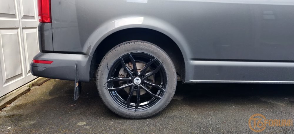

High rear end after H&R -40mm
csnell71
What wheel and tyre size have you got on ?? In pics looks totally standard like the van has had no drop at all. I've got -40mm springs on as well but on an empty T32 4Motion with DSG LWB with 20 x 9 all round on 40 profile tyres. So even though empty, a bit of extra weight from the DSG and 4Motion but obviously not the weight of a camper and associated kit. Leighton Vans have a huge showroom which I've been in a few times and they fit -40mm springs as standard with 20x9 as part of their LV Sports pack conversion (not campers). None of their vans look like yours either. IMHO something isn't right, or it's just that your wheels are tiny making it look like that. Mine looks like this empty :
It's got 18s because I wanted a smoother ride without scrubbing on lock, but I must admit it doesn't look right, have been for a ride yet so it's possible it hasn't bedded down properly yet.

Not sure what makes you think any of that. I've got 20's on with no scrubbing on lock or speed bumps. "Smoother ride" is obviously subjective and dependent on your van type and configuration and your personal preferences. You are already talking to Steve @CRS Performance. He has plenty of expertise and options for lowering with comfort, from comfort shocks to go with your springs, to fully adjustable coilover kits. If you actually would prefer to run bigger rims to get a certain 'look', don't write that desire off until you've read some of the posts on here and talked to someone like Steve who has posted extensively on this subject.
I wanted 20s and the guy at vanstyle advised against it which I accepted. Kinda wishing I hadn't gone for the 18s now. I'll have to talk to them tomorrow guess.
