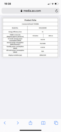

Hopefully some of you clever folk will help me with this. We are away this weekend and off grid. I really want to watch the match and so have hatched a plan. I have a 300w pure sine inverter which I plan to (hopefully) run a TV off for the football. The TV specs says if draws an average of 54w so using the 300w inverter via the 12v socket should be fine?? If so, the other consideration is battery drain. I don’t have a leisure battery so it would be drawing from the main battery, would a 54w draw for up to 2 hours kill it, if so would leaving the engine running for a while / the whole time keep things tip top? Pic of the tv specs and inverter specs below

Thanks Dellmassive, well my plans may have been blown out of the water this morning. The specs of the TV I got from the internet we’re that the Ran at 54w, now I have it in my hands it says it runs at 120w .
