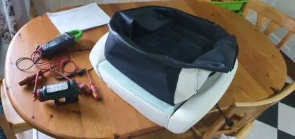

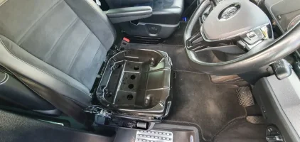

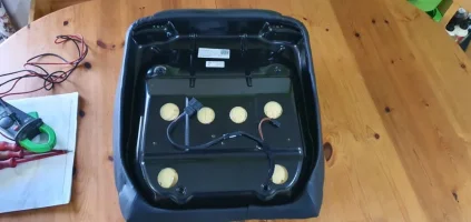

Seat base stripping.

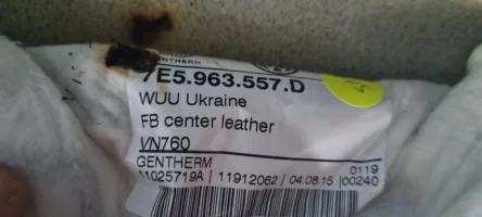

And the damage itself.

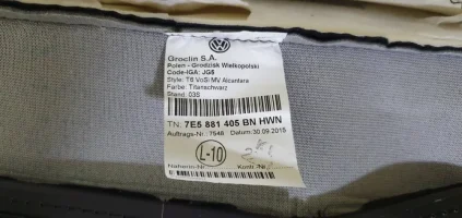

My cushion upholstery part number.
And actual heating element part number. Not possible to buy on it's own!

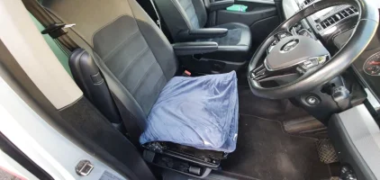

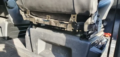

And my temporary seating during repair.:D

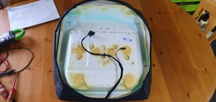

My faulty element dimensions.
And dimensions of new fabric upholstery heating element.
The difference in length is down to different way of attaching the heating element to the cushion, but effectively after installation the heating area remains the same:)
I had to cut out faulty heating element cause it was restricting heating power of the cushion.
Original connectors on my new heating element (7E5963555) before interlinking plug(white one) was swapped with my old one:thumbsup:
My old plug that allows to link in series cushion heating element with backrest one transferred to my new heating element.
