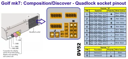

Now my next question is, what outputs on the speaker plug relate to the right and left channel from the head unit? I.e, brown 1 and 5 would be which side?

Fit your new iso pins into the spare pairs top and bottom of the brown connector - they are a pair of + / - at the top and same at the bottom, one right channel, one left (see diagram above)

I couldn't see a pin number on the brown block so can someone tell me which of my purple (top) or white (bottom) pair will be left and right, when looking at the back of the head unit:
I simply flagged one pair with insulating tape as I ran it through from the rear of the van, but I haven't cut the cable to length so I need to known which is which:
If it's wrong I can simply re-patch my connector but I'd prefer not to open the dash again

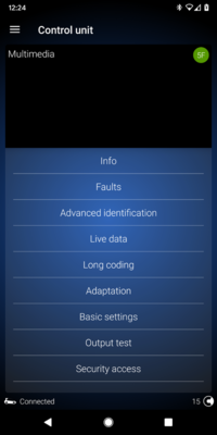

You need to enable the rear speakers in the ECU.
Long discussion here: Thread 'Can rear speakers be added to the standard head unit with front/ rear fader?' https://www.t6forum.com/threads/can...andard-head-unit-with-front-rear-fader.26559/
On my OBDeleven it's in the Multimedia module (5F on other systems)
And you enable two items on byte 4 channel 1 and two items on byte 4 channel 4: - there should be eight ticks in all.
Then, after committing the change, you need to reboot the head unit by holding in the power button until it reboots (15 secs+) and the VW screen appears.
Bingo!
