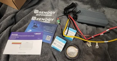

lets see what we get. . .

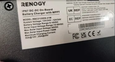

size wise its nice and small. . . and feels very durable with its all metal construction . . .
on the fron there is a mode button and 4x status LEDS, - the little sticky out bit is a plastic window in the metal case for the BT,
yes this unit has built in BT + APP support.
spec wise we have:
9v-16v Smart ALT input,
15-50v Solar PV input,
round the back we have this twin CAN Bus plugs - for connecting up to other CAN enabled Renogy Kit,
plus the IP67 loom, that has about 30cm of cable.
in the pack you get:
crimp terminals for a MIDI fuse holder,
role of leccy tape,
mounting screws,
a temp sensor,
Two ZIGBEE wifi switches
cable wise. . . we see something new here.
no remote voltage sampling,
and no IGN switch input.
this charger uses voltage detection to switch on (trigger point is adjustable to suit your install)
the install guide shows some nice details for fitting.
but not so sure about the twisty tape-y bit.. . .

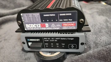

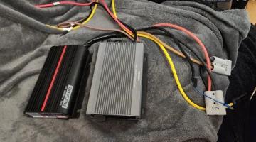

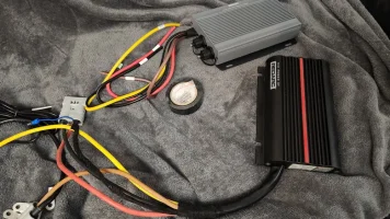

Hmmm - see this before?
well that what i thought. . .
have a look at this,
here is a REDARC BCDC1250D and the Renogy IP67 next to each other.
have Renogy white boxed a Redarc?
have they copied it?
are they working together?
is this the Redarc we always wanted - with BT & APP?
even the cable colours / style etc etc - all the same.

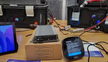

size wise its bigger than the web pics show. . .
round the back you can use USB-C to power it up.
here you can see a rough size comparision. . .
once conected to your 2.4G wifi (not 5G !)
it asks for FW updates etc. . .
there is a nice leveing page that can be used for your Van.
once connected to your phone APP, you can add devices. . .
it found the DC-DC charger easy and added it..

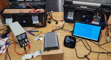

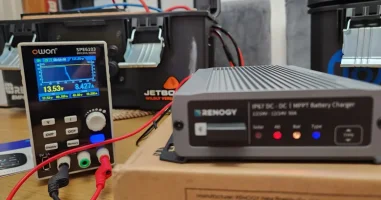

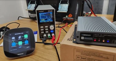

connecting up a PSU on the Solar side, the charger kicks into life. . .
one thing to note is that when you have ONE,
the DC Home APP has two modes . . .
internet based ONE Core mode like this. . .
and local BT mode, like this.
but it looks like the DC-DC charger can only be connect to one device, either the ONE or your phone,
so to get the DC-DC to conect localy to the Phone APP via BT, . . . we had to turn off the ONE.
then we could get to the settings page of the DC-DC charger - that wasn't available from the ONE side of things.
in the setting i was able to tweek the default Lifepo4 settings and current limit the unit from 50A to 10A for testing.
one of the main differences is now NO IGN feed.
the unit is auto matic. . .
and there is a setting in the same menu to set the trigger point . .
it was set to 13.8v, so i tweeked it to 13.5v to test.
sure enough as soon as the voltage was above that point the unit come to life,
indicating ALT charge.

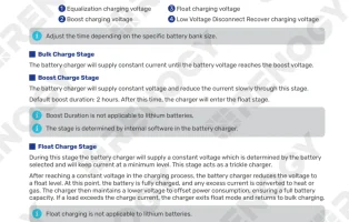

Charge profiles:
6.4.Activate Lithium BatteriesThe battery charger can activate connected lithium batteries. Lithium batteries may enter sleep modewhen the in-built protection is triggered. In such case, the battery charger provides a small current toreactivate the sleeping lithium battery. The lithium battery can be charged normally after successfulactivation.By default, the lithium activation function is enabled in the battery charger. You can disable it inthe DC Home app.
█ Operation ConditionSet the battery type of the battery charger to LI or USER. For details, see “6.1. Set a Battery Type”.█ Operation Logicz For 12V Lithium BatteryIf the battery voltage drops below 9V, the battery charger automatically activates the activationfunction (on the premise that the activation function is enabled in the DC Home app) and continuesto charge the battery using constant voltage until the battery voltage reaches 14.4V.
8.2.Charging LogicThe battery charger allows you to charge the auxiliary battery with a starter battery connected to analternator, with solar panels connected directly to the battery charger, or with both solar panel andstarter battery. The charging logic depends on the connection method.The battery charger employs the “Solar Power Green Priority” logic for charging. The battery chargerdetermines the charging source by assessing the adequacy of solar power using the following formula.Solar-generated Power = LowSolar Current Shuntdown x Output Voltage of the Battery ChargerYou need to customize the “LowSolar Current Shuntdown” through the DC Home app.Please refer to the actual displays in the DC Home app for the default value and setting range ofLowSolar Current Shuntdown.The maximum charging power from the battery charger is not affected by the system voltage andremains at 720W.█ When Solar-Generated Power is AdequateThe battery charger charges the auxiliary battery using solar power only when the solar-generatedpower is adequate. For details, see the table below:Working Conditions Stop ConditionsSolar input voltage > 15VAfter a delay of 10 seconds, the battery chargerwill exclusively utilize the current provided by thesolar panel for charging.Solar input voltage < 15VThe battery charger stops exclusively using thesolar panel for charging.█ When Solar-Generated Power is Slightly InadequateThe battery charger adopts both solar power and the starter battery to charge the auxiliary batterywhen the solar-generated power is slightly inadequate.Starter BatteryNominal Voltage Working Conditions Stop Conditions12VSolar input voltage < 15VandStarter battery voltage > 13.2VSolar input voltage > 15VorStarter battery voltage < 12.7V24VSolar input voltage < 15VandStarter battery voltage > 26.4VSolar input voltage > 15VorStarter battery voltage < 25.4VThe parameters in the above table are default values, and you can customize them throughthe DC Home app. Please refer to the actual displays in the DC Home app for the specificcustomization range.Please consult the vehicle manufacturer before modifying the voltage values for the workingand stop conditions of the starter battery. Failure to do so may result in the starter battery beingdepleted due to excessive discharge.— 34 —█ When Solar-Generated Power is Severely InadequateWhen solar power is severely inadequate, the battery charger charges the auxiliary battery by utilizingonly the starter battery.Starter BatteryNominal Voltage Working Conditions Stop Conditions12VSolar output current <LowSolar Current ShuntdownandStarter battery voltage > 13.2VAfter 15 seconds, the battery chargerwill utilize the current provided by thestarter battery for charging.Solar output current >LowSolar Current ShuntdownorStarter battery voltage < 12.7V24VSolar output current <LowSolar Current ShuntdownandStarter battery voltage > 26.4VAfter 15 seconds, the battery chargerwill utilize the current provided by thestarter battery for charging.Solar output current >LowSolar Current ShuntdownorStarter battery voltage < 25.4VThe parameters “LowSolar Current Shutdown” and “Starter Battery Voltage” in the above tableare default values, and you can customize them through the DC Home app. Please refer to theactual displays in the DC Home app for the specific customization range.Please consult the vehicle manufacturer before modifying the voltage values for the workingand stop conditions of the starter battery. Failure to do so may result in the starter battery beingdepleted due to excessive discharge.█ Trickle Charging Starter BatteryOnce the auxiliary battery is fully charged, the battery charger will utilize the solar panel to provide atrickle charge to the starter battery.Starter BatteryNominal Voltage Working Conditions Stop ConditionsMaximum ChargingVoltage for theStarter Battery12Vz Auxiliary batteryfully chargedz 6V < StarterBattery Voltage <13.2VThe solar panel continuouslycharges the starter battery for 1minute, followed by a 30-secondpause. During this time, the voltageof the starter battery is monitored.If the starter battery voltage isgreater than 13.2V, charging will bestopped. Otherwise, the chargingcycle will continue.13.8V24Vz Auxiliary batteryfully chargedz 12V < StarterBattery Voltage <26.4VThe solar panel continuouslycharges the starter battery for 1minute, followed by a 30-secondpause. During this time, the voltageof the starter battery is monitored.If the starter battery voltage isgreater than 26.4V, charging will bestopped. Otherwise, the chargingcycle will continue.27.6V

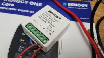

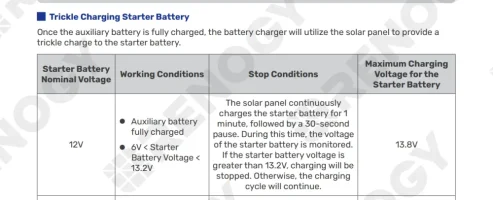

ZIGBEE . . . . ( wifi smart switch in the van )
we had two Zigbee wifif switches in the box,
powering up the Zigbee with a 12v supply,
the unit is visable to the core ONE,
and super easy to add,
once added you can see and use them in the HOME app or via the ONE screen.
licking the APP or ONE screen will toggle the Zigbee on/off.
there is also a button on the unit that does the same.
you can wire a switch to S1 or K1 to toggle on/off as well.
you can then wire up the switch 12v output to run your kit.
12vdc up to 15A
ie lights or whatever.
there are logs and scenes that you can set cause=effect routines.
a great little addition. . .
Charging stages:
