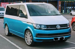

What width are the RR wheels?Hi,
They look good.

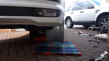

I have just bought some Range Range 20" wheels and planning on having them refurbished in black. Although all new to this and having read your posts worried about the load ratings.
I've ordered some 275/40 tyres for my T6. My next issue is finding some center caps and longer bolts as the ones i have seem to short at 35mm and corroded. Any suggestions that doesn't involve all that you went through, did you find/source any that didn't need modifying? cheers

What variant is your van T28/30/32?
Here's the answer to load rating on LR wheels: Load rating on Land Rover/Range Rover wheels - SOLVED
LTC Tyres will give best advice on bolts, spigot rings and spacers (although you need to decide on spacing). My opinion is that non-staggered rims need +10mm at the back, but you need to use a tyre calculator to make sure they aren't already sticking out too far.
