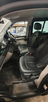

I did have some Vauxhall insignia seats in mine and had this exact problem, the back rest was lovely but the base just wouldn't allow you to spread your legs far enough. I've since replaced them with some heated leather seats from a 2016 Audi A6 which work perfectly for me and were a doddle to add armrests to.20210108_161706.jpg
