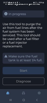

Carista shows the option to run the fuel pumps.....
I've got the V1 dongle and the EVO.
Screenshot below from the app, I have a subscription. And using the EVO.
Screenshot_20250209_093654_Carista.jpgScreenshot_20250209_093726_Carista.jpgScreenshot_20250209_093711_Carista.jpg
