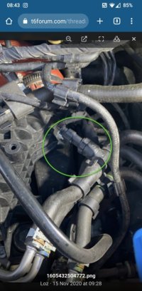

So this is the reason. Sensor rubbing on the pipe and its wore the insulation away. Quick trip to carrs vw and jack the workshop controller sorted it for me in 10 minutes. Very clued up guy and a gent.
ah, the fuel temperature sensor cable issue...
Yeah thats the one and my air box pipe was loose and that can also cause an issue as well. Gotta love this forum..

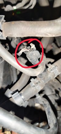

Flashing coil light again (not mine again, this is the first time. I had a look and sure enough found this: any suggestions (it's booked into the garage next Friday but I'd like to use it this weekend... Notice the bare wires. What do the garage do? I assume just order a pre connector and cut back the loom? Or worse, just cut back bare and crimp (I blumin hope not!)
Broken wires. I cut the wires at the connector. There are around 5-10 mm left on the plug. I stripped the insulation back to bare the copper. The loom is in a worst state. The outer protective cover was opened with a sharp blade, being careful to cut in and up, so not nic the insulation. But as solder would not take, I had to open more if the insulation back to near the start of the branch. Managed to semi tin the wires, after grabbing them with fine san paper, in an attempt to clean the copper. Then as solder didn't work, I crimped the copper lines together. Plugged back in to the sensor and the coil remained unlit. YES!! The engine light did remain lit though.

My van is fixed, albeit temporarily as I want a proper fix to the fuel temp sensor wires, (P0138 fault code) so will order new parts and drop it off at the garage next Friday.
Great thread, another issue resolved by us!
I have a small tub of plumbers acid flux that is good for those ends that won’t tin. You can buy the pins that go into the plug and make new tails if you need to.
I have ordered a new connector with 'tails', crimped wires plugged into the connector. If should arrive Tuesday. I'll look for Plumbers Acid Flux, thanks for the tip. The solder I have has flux in the core but the wires would not take, even when left hot for a while.
