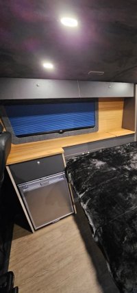

Hi, Im in the process of converting my van and have almost finished installing a Van Furniture Kitchen Pod, the only thing I have left to do is the lockers over the kitchen, is this just a simple case of using self tapping screws and fixing into the frame for the Skyline pop top? Photos for reference.
I installed mine with 6 x 6mm rivet nuts. I had to cut the cupboard to the correct profile first and is held very firmly in place.
Some more pics of inside the cupboard as to how you specifically installed the rivet nuts etc?
Just taken these pictures. I only used four rivet nuts M5 for the cabinet blocks and two screws at the rear to fasten it to the wardrobe.
At left hand end (front) there are two top front and back of the cupboard.
in the middle there is a divider so one either side staggered front and back.
on the right (rear) I drilled two pilot holes to screw it into the wardrobe unit.
