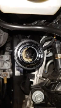

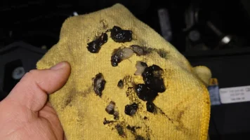

Noticed the common condensate in the filler cap, I know it's a common occurrence: Condensate TPI
All the photos I've seen show it white mine looks like quite a lot of black in it.... Guessing more oil vapour mixing in.
Just checking if this black hue is normal?
Just had an oil change at a VW dealer too.
As expected at this time of year! As long as the oil and coolant levels are not suddenly changing, there's nothing to worry about.
My 2022 T6.1 is exactly the same, I asked the Tech at VW he said it was completely normal, and he wished he had a pound for every time he's been asked to look at one
