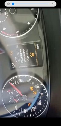

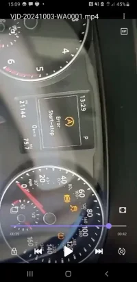

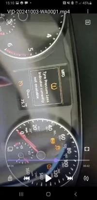

Hi All,
I get the following error messages in order:
1. Tyre Pressure Loss indicator currently not available
2. Error: Start-stop
3. Error: ABS/Stabilisation control (ESC)
These messages all started flashing up a couple of weeks ago and then disappear after about 10mins. At first they were intermittent, every other journey. Now they flash up every journey.
Any idea what could be causing this and how it can be put right?
I’d really appreciate any help!
I’ve attached pics from the dashboard of the messages.
Cheers
All of those systems rely on the wheel speed sensors so highly likely to be one of those failing or the wiring to it.
