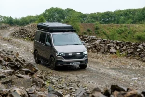

We’ve just finished an epic swamper camper build at the cave with full interior, exterior and audio modifications. Let’s start with the exterior….
101E995B-DE99-49AD-BA88-5B92FC4146B8.jpegE8D58667-C16D-4F9B-926A-C49967126139.jpegDA713E30-7E94-43CB-92B1-34EB1536F08C.jpeg96C8C696-6AD7-4ECE-9BB0-7467E0033B59.jpeg
35mm lift kit with upgraded shocks and springs.
Full swamper trims including arches, side trims, front and rear skid plates.
Fuel Zephyr in Bronze with BFG AT tyres.
Laser lights in the grille with full canbus integration.
Matt black badges and grill trims.
Front runner roof rack.
Fiamma 45S awning mounted to custom roof rack side mounts.
Tuff Trek roof tent with lighting and 12v power.
Matt black aluminium side steps.
We think this thing looks epic, what do you think?

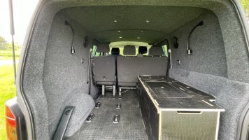

926EEBF1-6D9A-4A50-A3FC-79D73780D99F.jpeg5B3ED460-93F8-4C66-A2BA-A6B41AF6B08D.jpeg293A0D4D-00F1-4291-8202-4B38EE125717.jpegAA13624E-F408-4A0B-9B80-C07E263F66F8.jpeg6C9E82A6-814F-463E-B0F9-9AE6FE0CB7EC.jpeg1A1A0FAA-8B47-411F-9B3E-D0F54932BAD4.jpeg14A37931-5927-43C0-9CFE-C8FD1DA2190E.jpeg35E734EA-9F8D-4819-93C0-CB049E28A6E2.jpeg93270D8B-B81B-41D2-A4C2-523276D0FDC0.jpeg86A43D8A-C7A4-407F-AE46-B5074BA9B54B.jpeg
The customer had already insulated and sound deadened the rear of the van, so we added the following:
Sound deadening and insulation to front doors outer skin.
Sound deadening to front doors inner skin.
Focal front speaker and tweeter upgrade.
Focal rear speakers and fader enablement.
Focal amplifier.
Sound deadening and insulation to cab roof.
Full carpet lining from B pillar back.
240v hookup under bonnet.
Victron Bluetooth charger and mains consumer unit under drivers seat.
240v sockets under drivers seat and in rear panels.
Victron Bluetooth DC-DC charger for leisure battery under passenger seat to replace OEM split charge.
Driver and passenger swivel seat bases.
B pillar USB sockets.
12v power outlet mounted in rear side panel.
LED spotlights.
LED reading lights.
Vanshades windows blinds.
3rd row single Kombi seat with integrated seatbelt (not pictured, but you can see the floor mounts we’ve added!)
This really has been a massive build with a huge list of mods inside and out, but our customer has ended up with a simply fantastic off road camper!

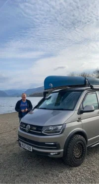

@The Van Cave Hi Chris, is this the suspension setup we have been discussing for my Van but with 35mm lift rather than the 25mm we have discussed?
No it's not Dave. This van was built with regular and fairly serious off road use in mind, so it's got a kit that's designed to withstand those demands. It's worth bearing in mind that despite it being a 35mm lift kit, the van didn't go up quite that far. It's a pretty heavy van with 4motion, DSG, 204 engine, ply units and bed, roof rack and roof tent, so the lift was closer to 25-30mm above standard.
The van pictured below is running the exact suspension setup that we've been discussing and drives beautifully.
