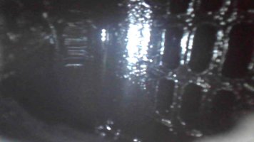

2018 150bhp manual, 58k miles. Low coolant warning, so topped it up and checking regularly, it's dropped a bit more, and no external leaks, so suspect it's going in the engine.
EGR cooler issues common, so I removed the front exhaust EGR pipe and had a look with my endoscope, and it looks quite wet, but I don't actually know what it would normally look like!...
Has anyone tried to diagnose like this, and does this look suspicious?

I am no expert but surely that can not be right mate. If you are loosing coolant then there is a good chance that’s where it is going. Can you rig something up to pressure test it?

I bit the bullet and bought the genuine VW cooler, bolts and gaskets (just the heat exchanger, not the EGR valve unit) £310 delivered.
Removed the old unit, separated the cooler and rigged up a bench test: it failed: it was leaking somewhere inside.
Rebuilt the EGR with the new cooler and refitted: seems fine now.
If anyone else suspects their EGR cooler failed: looking inside with a cheap endoscope is an easy way to diagnose - it shouldn't look wet.
