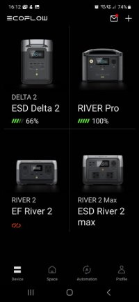

That looks like an EF River Pro. Gen1.
I have one of them, I'll fire it up and see what it says regards to a FW update.
I wonder if there is a way to force load a FW file?
Normally FW can only be automatic via the APP.
If a FW update is available is shows in teh notifications area of the app. I saw that I had a FW update to apply and applied it. The rest is history!

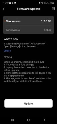

Looks like it's showing a FW updates available.
Screenshot_20231112_161347.jpgScreenshot_20231112_161319.jpgScreenshot_20231112_161248.jpgScreenshot_20231112_161325.jpg20231112_160622.jpg
