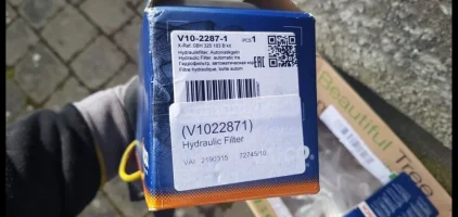

Thanks @buchanan84 . I assumed there was, the same as other DSG boxes, as you described. :)
Need to find the part number now - VW or Bosch hopefully. :thumbsup:

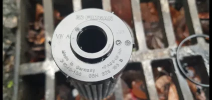

Hiya, Just out of curiosity, did you change the DSG oil filter at the same time?. Its a bstard to get to so was just wondering.
Yes I did, but it is much easier than it appears to be. I used two long extensions together and got it loosen from the top and then I undid the rest by hand from the bottom. There is enough space behind the steering rack.
Reactions: mmi
Ok thanks, I just couldn't get decent purchase on it to get the first turn in. which way did you get to it initially?, via the left hand side of the engine bay (as you look at it) and behind the exhaust or right hand side, between the brake pipes and the oil cooler pipes. (CFXA Engine, 150HP)
