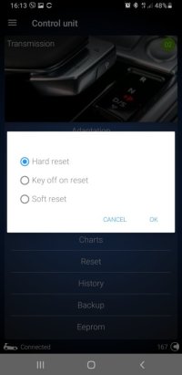

Can someone tell me what does this mean? Control unit -Transmission - reset. I am using OBD eleven. VW Caravelle 2016 2.0 150 DSG
