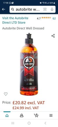

Was it frozen stuck?
Ie the rubber seal to the van?
Or a mechanical problem.
This is the best stuff ever for playing trim and tyres.
But also works on for trims.
And still stop them from freezing stuck to the van.
